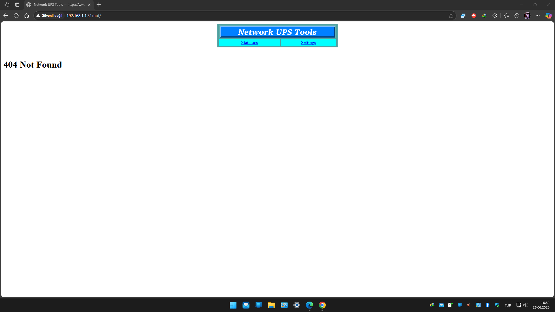

  1. Solved. install nutserver. https://forum.keenetic.ru/topic/6019-настройка-nut-для-keenetic/page/2/ install lighttpd lighttpd mod-cgi Add / Edit lighttpd.conf: server.port = 81 server.modules + = ("mod_cgi") $HTTP["url"] =~ "^/cgi-bin" { cgi.assign = ( "" => "" ) } make directory inside cgi-bin: mkdir -p /opt/share/www/cgi-bin/nut move Files: mv /opt/share/www/cgi-bin/upsimage.cgi /opt/share/www/cgi-bin/upsset.cgi /opt/share/www/cgi-bin/upsstats.cgi /opt/share/www/cgi-bin/nut/ set the execution permissions :chmod +x /opt/share/www/cgi-bin/nut/*.cgi if you want web contol edit /opt/etc/nut/upsset.conf: remove first 3 ### character I_HAVE_SECURED_MY_CGI_DIRECTORY line. Restart lighttpd: /opt/etc/init.d/S80lighttpd restart open : http://192.168.1.1:81/nut/
