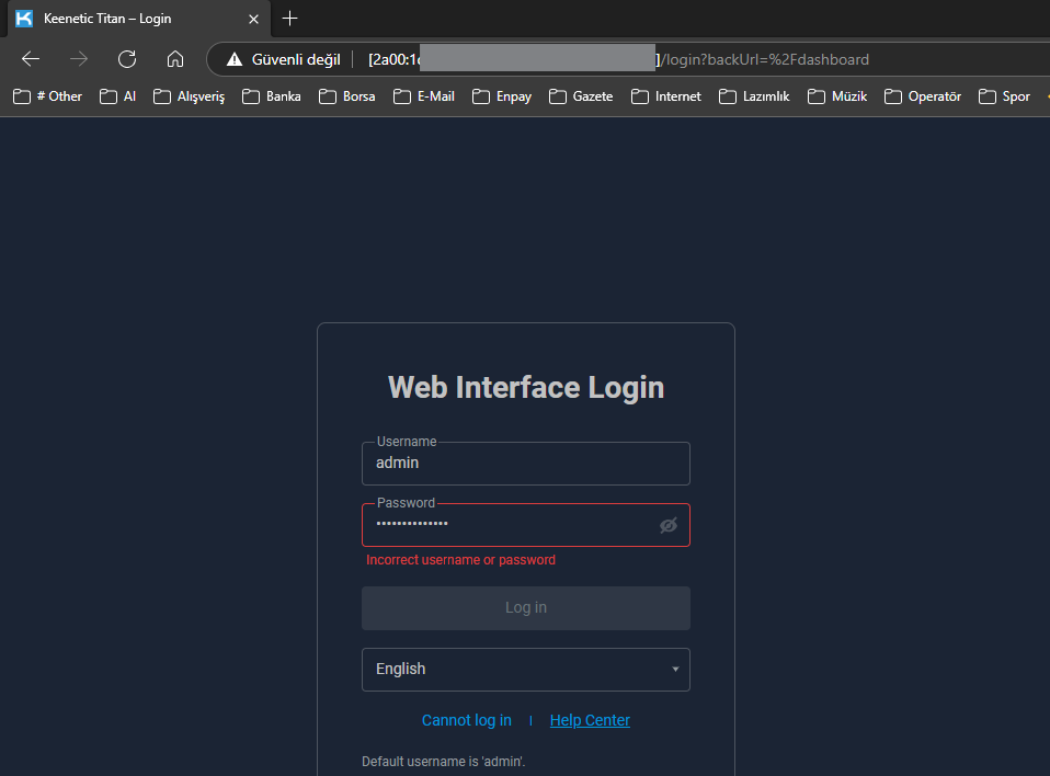

  4. When I try to access the Keenetic web interface over IPv6 from an external network, the login screen appears, but my username and password are not accepted — even though remote web access is enabled for both HTTP and HTTPS. The same credentials work fine when accessing locally. Is this a bug, or is there an additional restriction on IPv6 remote access that I might be missing?

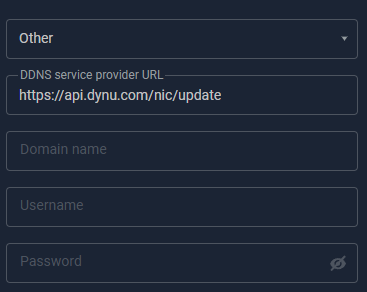

  5. Hi, I'm using the DynDNS client on a Keenetic router with the Dynu service. I have a profile (e.g., "_WEBADMIN") that successfully updates both IPv4 and IPv6 addresses only when first configured. However, when the router reboots and the WAN IPv6 address changes, the DDNS client only updates the IPv4 address. In the system log, I see: [W] ndm: DynDns::Profile: "_WEBADMIN": IPv6 update disabled (disabled). The strange part is that the initial IPv6 update works when the profile is created. But on subsequent IP changes (especially after reboot), IPv6 is not updated anymore, even though it is clearly supported by the provider and initially worked. I could not find any CLI command to explicitly enable IPv6 updates for a DynDNS profile. Is this a bug, or is there a hidden setting that must be enabled? Thanks in advance. Also, could Dynu service be officially added as a provider option?

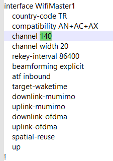

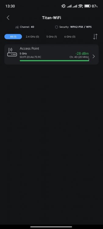

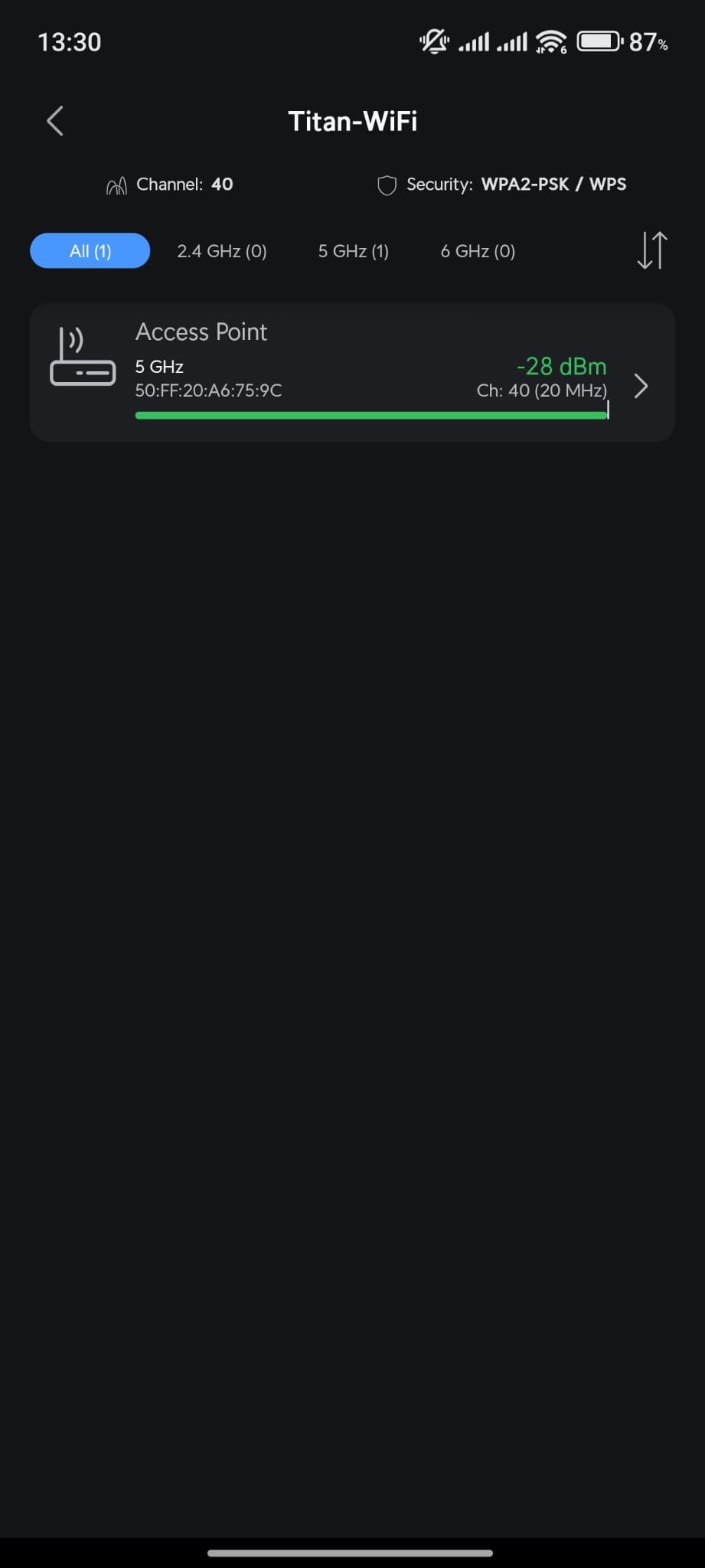

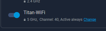

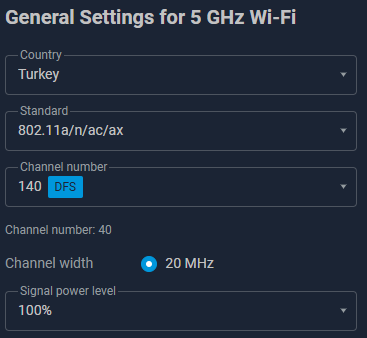

  6. There is an issue in version 5.0.A5. When I change the Wi-Fi channel from My Networks > Wi-Fi > Advanced Settings, the change is not immediately applied — the active channel remains the same. However, the new channel value is saved to both the startup-config and running-config files. After a reboot, the device starts with the last saved channel (as per the config), but the change does not take effect instantly when applied from the interface. It seems the configuration is written correctly but not pushed to the interface runtime unless the system is rebooted.

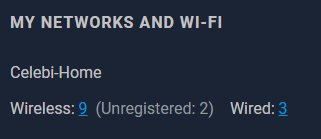

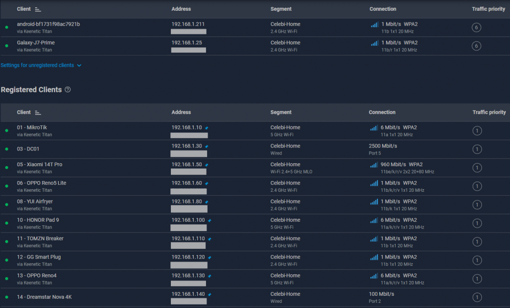

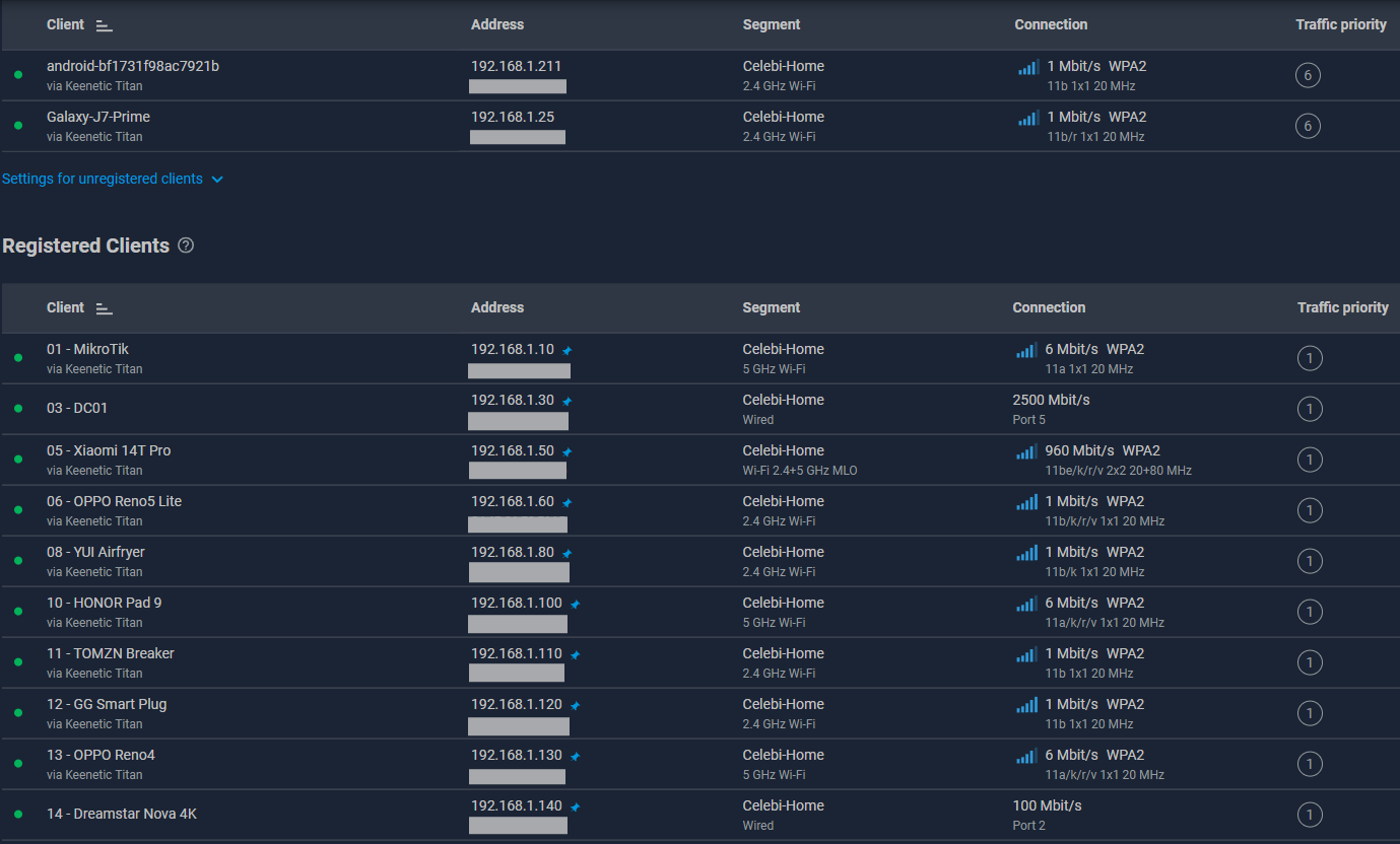

  7. Hello, I am using the new Keenetic Titan (KN-1812) model. The connection speeds of the devices on the client screen are displayed incorrectly. Sometimes these values correct themselves, but not always. This issue used to occur only with one IoT device (a dryer) on my previous router, but now, even though a few devices may show the correct speed, most of them are still displayed as 1 Mbit/s. Also, as shown in the list, there are a total of 12 clients connected. However, the counter shows 9 of them as wireless and 3 as wired. The correct count should be 10 wireless and 2 wired clients. For some reason, wireless clients connected via MLO are shown as wireless in the list, but they are counted as wired. Preview - 4.3.3
  8. Hi @eralde It looks the same on my side as well. I’ve attached a screenshot. I’ve also created a read-only account so you can check it yourself — I’ve sent the login details via DM."

  12. I’m in the same situation as you — my ISP only provides IPv4 through CGNAT, but I do receive a public /56 IPv6 prefix, which I actively use. 1. Web Interface Access over IPv6 You can access Keenetic's web interface remotely via IPv6, but only if HTTP is enabled. HTTPS does not work at all, because Keenetic does not have a valid SSL certificate installed by default. That’s why HTTPS connections are rejected by browsers. To enable HTTP access: Go to Users & Access > Management Access in the Keenetic web interface. Enable the "Remote web access" option. Make sure only HTTP is selected (HTTPS won’t work without a valid certificate). Copy the device's IPv6 address from the interface. Access it in your browser like this: http://[your_ipv6_address] 2. Telnet and SSH Access over IPv6 Telnet works over IPv6. You can connect to Keenetic using a Telnet client and the device’s global IPv6 address. SSH does not work over IPv6, even if it’s enabled in the web interface. This is likely because Keenetic does not support SSH over IPv6 at all (at least in current firmware versions).

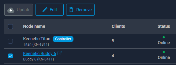

  13. Please consider adding a "Reboot" button next to the existing Edit and Remove buttons in the mesh device management interface. Currently, restarting a mesh node requires logging into each device separately, which is inefficient and time-consuming. Suggested Placement: [Update] [Edit] [Remove] [Reboot] This addition would make it much easier to manage and restart mesh nodes directly from the controller interface.
