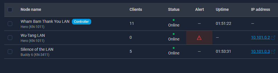

Request: The user should not change the type of the port used for the mesh or the warning must be added. Today I met a user scenario. It was completely inexperienced. There is a Keenetic cable mesh system and there was a change of ISP. The user has chosen the ethernet port (Port 1) that be mesh with the cable as a provider. (Actually, it is enough to change the existing provider (port 0) that only PPPOE information.) After that, problem is occured. He removed it from the interface, but the mesh did not continue as a cable. When Backhaul activated it, mesh continued via wireless. When I looked at the Running-Config, there were outputs that were not in the interface but were configuated. And this was integrated with the Wan (Gigabitethernet1) connection. Sağlayıcı 2 is not visible in the interface. Starting with 10.160.xx.yy IP is for IpoE. (ONT without pppoe) Instead of cleaning the crumbs with the command, I created a provider in the interface again, and I chose the port default. Then I deleted this interface. Mesh was active again via cable. (I removed extender before, so I added it again.) I'm adding the self-test that I have taken to the next message after I follow these steps. I hope it's not wrong and you can catch the situation. @eralde @Le ecureuil -

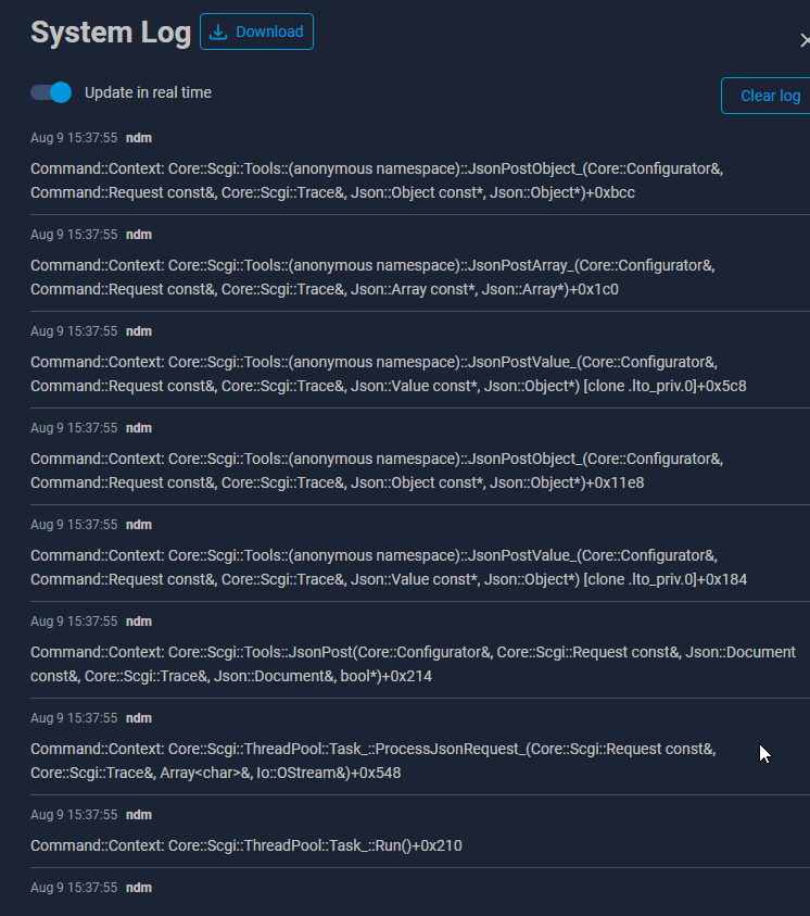

Hello, The main controller is not updated with the button which is "Update KeeneticOS on all nodes" I also tried my 2 mesh system. [I] Feb 28 06:59:38 ndm: Mws::Controller::Updater: "50:ff:20:2a:dc:25": checking for an update. [I] Feb 28 06:59:38 ndm: Mws::Controller::MemberList: checking for updates. [I] Feb 28 06:59:50 ndm: Mws::Controller::Updater: "50:ff:20:2a:dc:25": pending update, "(auto)" sandbox. [I] Feb 28 06:59:50 ndm: Mws::Controller::Manager: updating members. [I] Feb 28 07:03:38 ndm: Mws::Controller::Updater: "50:ff:20:2a:dc:25": update completed. I could not see that the main controller was added to the update queue in logs and records. I add self-test to the next hidden message.
