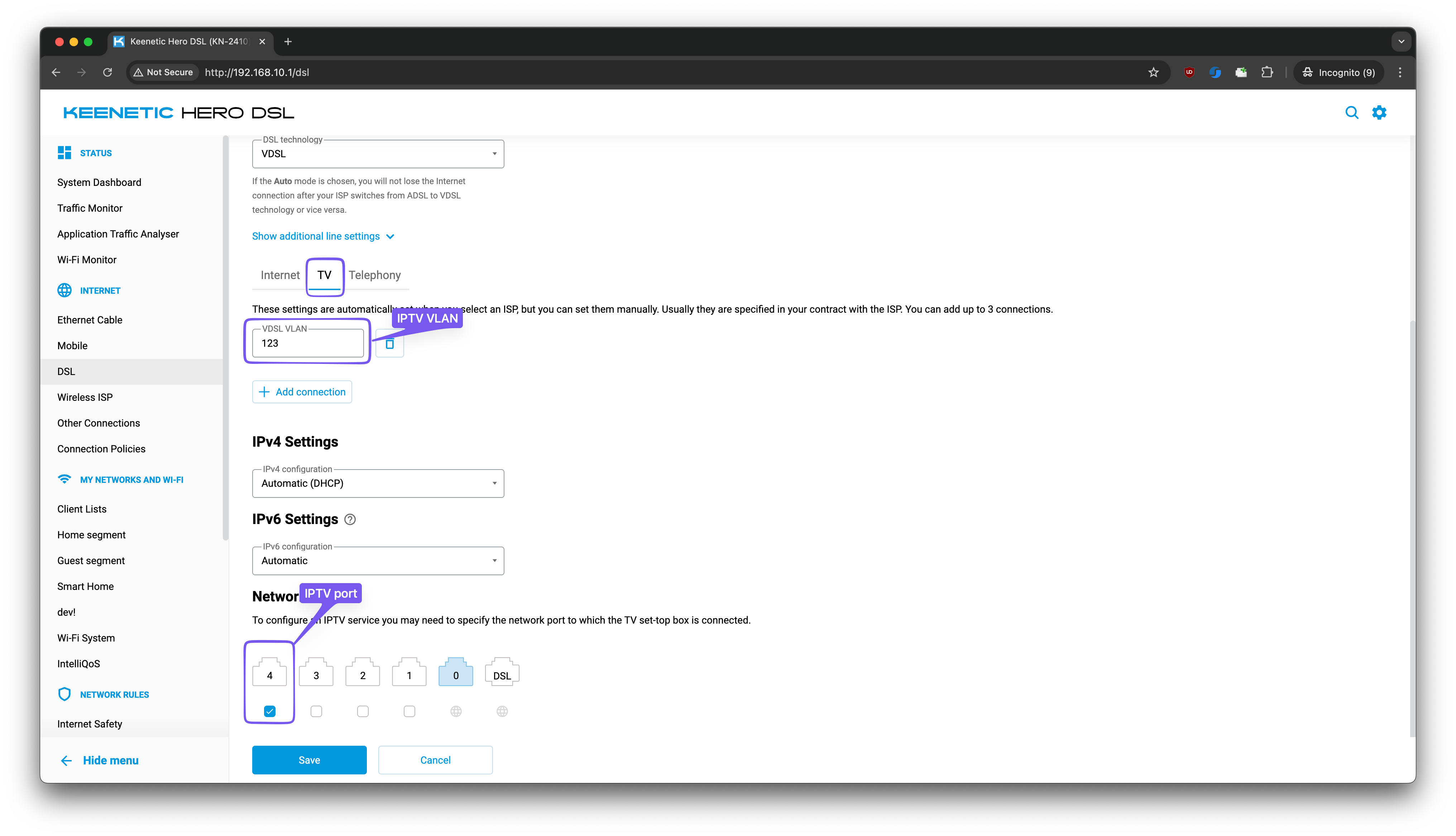

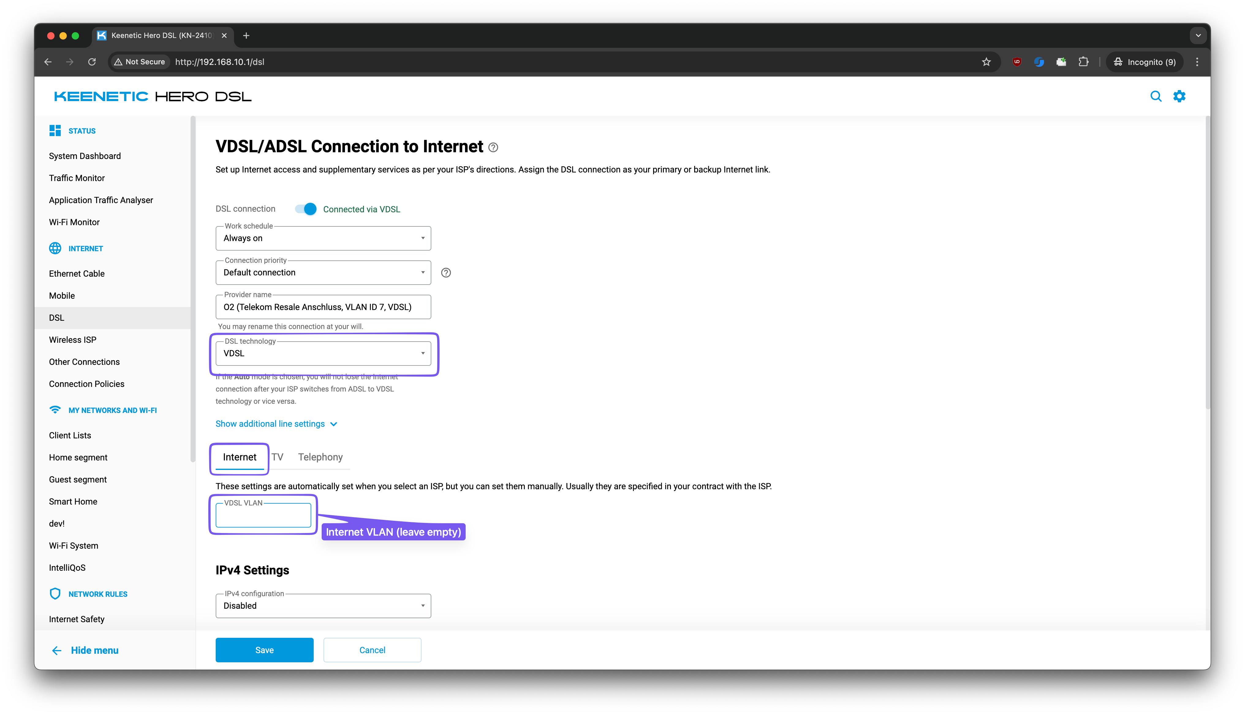

KN-3610 simultaneus untaged and taged VDSL VLAN possible?
eralde replied to moij258's question in Community Support & Knowledge Exchange
Yes, this configuration (no VLAN for the Internet, only for IPTV) should work as you expect. I hope that helps 🙂 -
@moij258 if I understand you correctly, your goal is to configure something like this (in my example I configure the IPTV VLAN on the port #4): -
