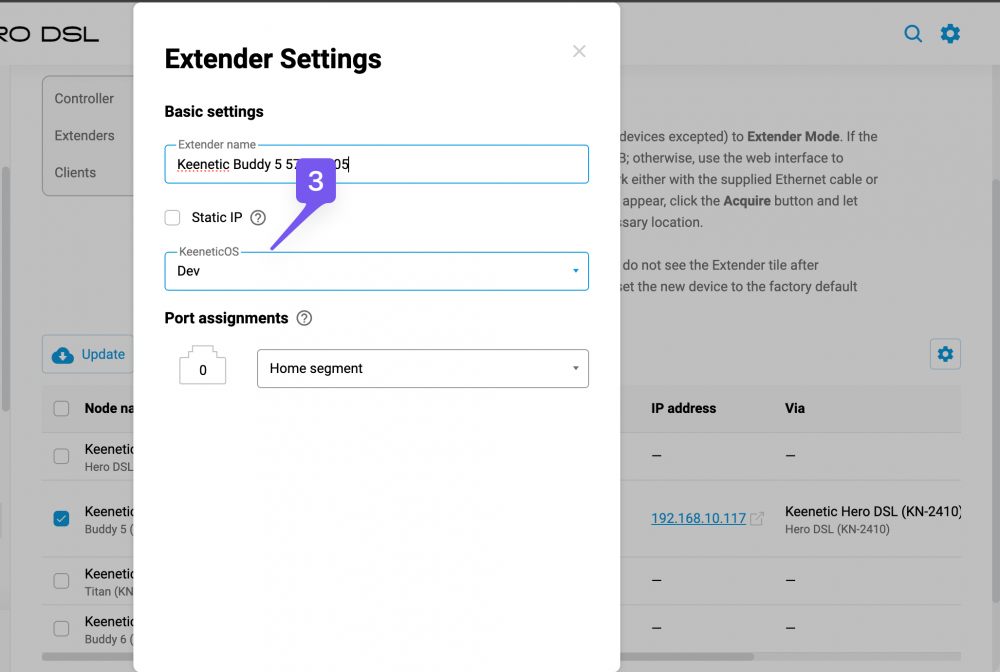

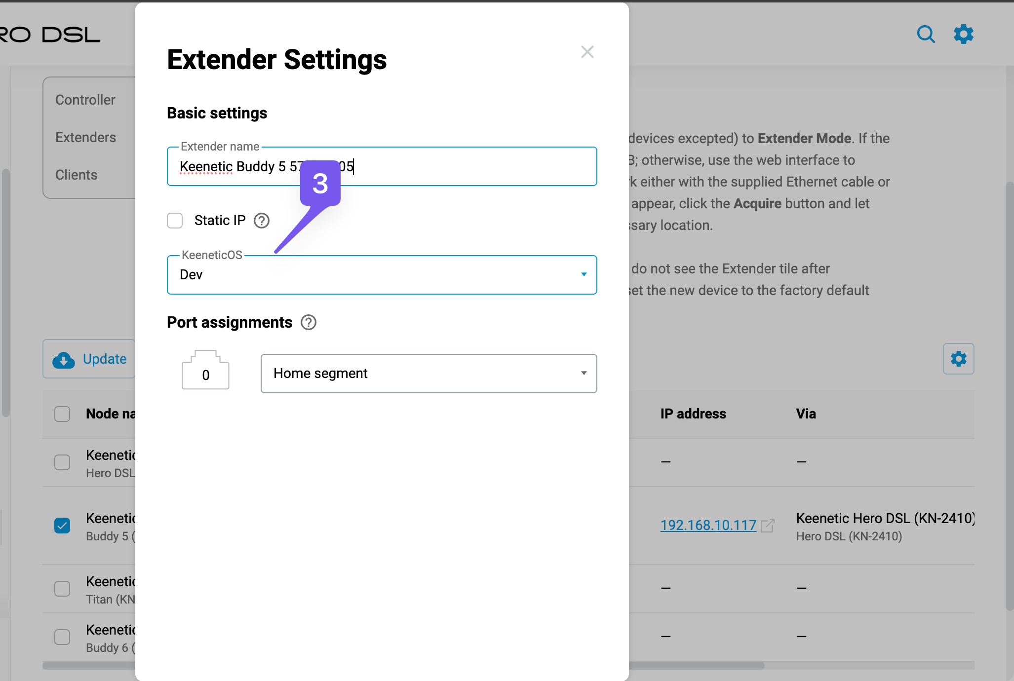

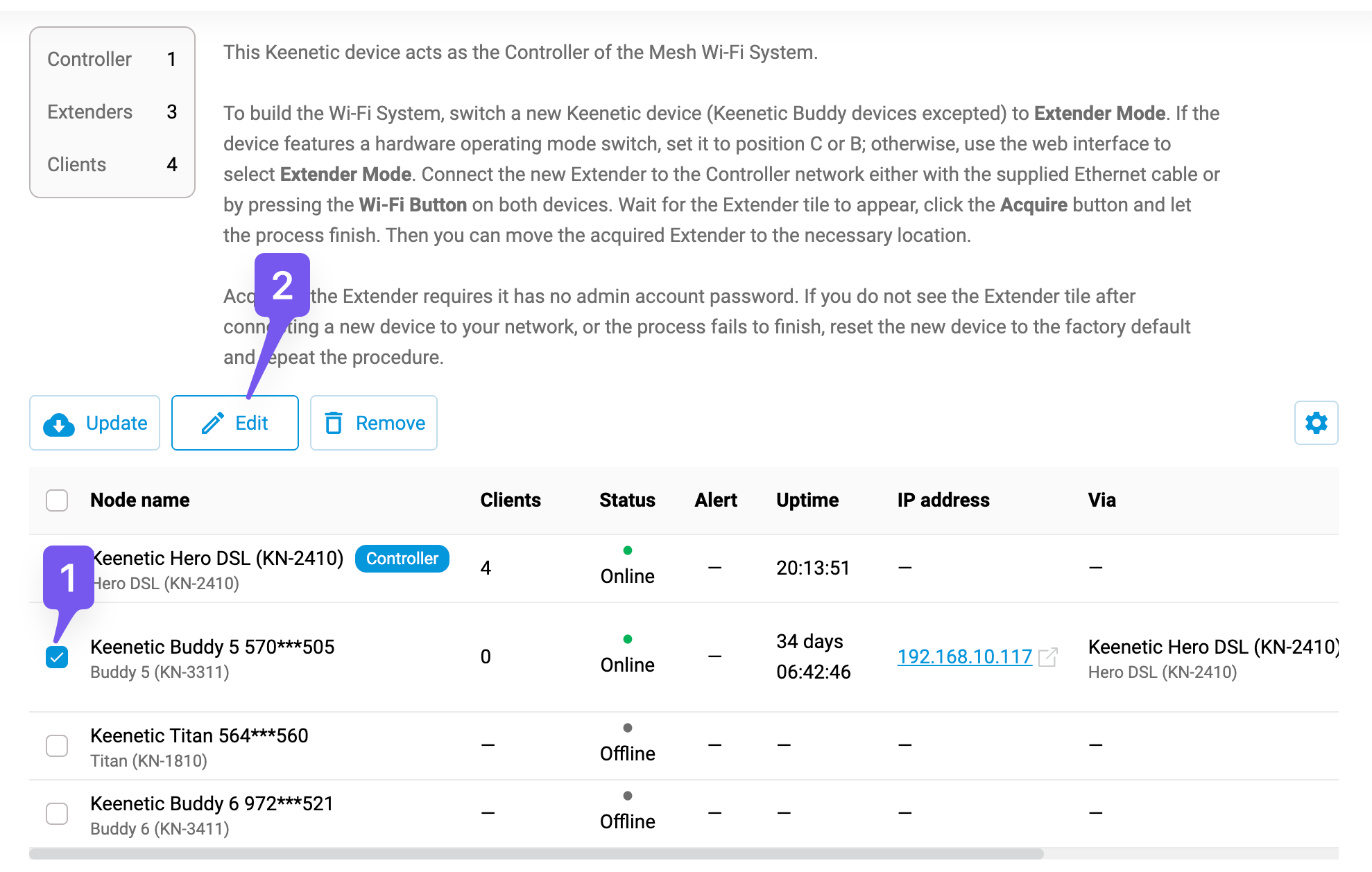

Update channel not changing for mesh members
eralde replied to muzo178's question in Dev channel issues & test reports
The controller update channel is not propagated to the extender devices, this is the expected behavior.
